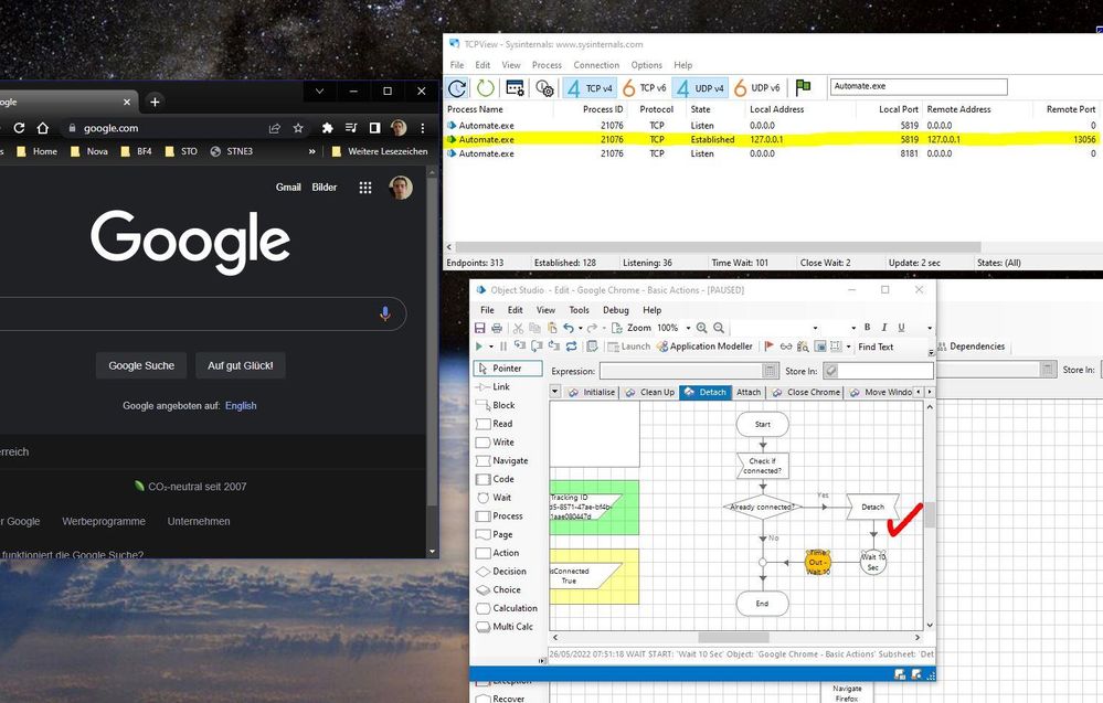

Launching the first Browser (Exmpl. Firefox) is ok, BUT, when launching the 2nd Browser (Chrome), the launch Action fails with message that the Extension is not installed.
I checked a lot of things already, following the Guides and different support Threads, but nothing helped.
What i found out is that the BP Agent launches the 2nd Browser on the same Extension Port!
(Fixed 31924 Setting is OFF, ephemeral port environment and tracking ID)
If it launched Firefox, i see Port 28647 for example is used by the Agent.
When i launch the 2nd Browser, on the "Redirect Page" which comes up before loading the Startpage - it has the Parameters also with that same Port and it seems the Extension from 2nd Browser tries to connect also to Port 28647 - which will not work and then the Launch fails, after some waiting.
Funny thing is - i saw, if i change the Objects Application Mode to 64 Bit, it can launch both Browsers and the agent gives them different Ports, but nothing except the Launch works then.

Yes, that things i tried already, also switched to newest Browser Version, which are working, as long as they are alone.
To test it more in Detail i also did a Test Setup of BP7 in my private Env. and tried the same things there - first i was excited, because i could launch the browsers, chrome, edge and firefox in parallel, but when doing some actions in the browsers - some of them were directed into the wrong Browser and Elements were not found, probably because they were read from the wrong browser (with a different Page loaded)...
For Example i´ve sent a Navigate to Chrome, attached and with Trackin ID for the Action - Action was going to Edge, which is also attached, but different Page and different Tracking ID.
Tracking ID seems to be completely useless for that (passing it to every Action and Browser i did)
So back to Experiments with BP 6.10.4 - where we still have the issue.
Btw. Firefox we use an ESR Version, which are completely missing in the List (but i think one of the common type of Browser Versions in Companies), Chrome and Edge are matching, but they´re also not working in parallel.
Meanwhile its getting really annoying and we loosing a lot of time with investigating and testing Things with the Browsers.

They have confirmed that the use of multiple browser types concurrently is not something we have specifically built into the v6.x. What you experienced is essentially how the product behaves. For v7.x, the use of multiple browser types concurrently has not been specifically tested either, but with the implementation of Native Messaging Host, it is technically feasible to achieve this. It may very well be possible as of right now.
The current recommendation for v6.x is to switch between browsers of different types using detach and attach, so that Blue Prism can limit its interaction to a specific browser only.
Sorry, but... no - because the Extension will not disconnect when you detach, so launching another browser will fail still with Extension or Port Error.
Think the only possible Way in that Case is - terminate the 1st Browser, wait ~5-10 Secs, launch the 2nd and do the things.

Sure, we had it before, but no way to switch back, as we already working with Tracking IDs now.
And also tried to just change it few minutes ago, now 31924, exact same behavior, port keeps in use after detach.
