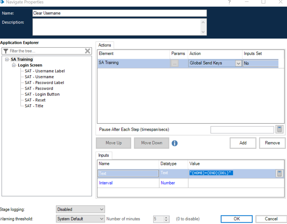

Hello all,
On the website I am automating there is an input box that is sometimes empty, sometimes not, but I want the automation to clear this box every time before clicking next.
I have been reading about using a write stage or global send keys to delete any values, but am confused about how to implement either approach (and it looks like best practice is to try a write stage first).
I attached a couple of screenshots of what I attempted to write for both approaches... can someone please explain the best way to clear values from an input box?
I don't know if this is useful, but I am using Google Chrome and had to use the input box HTML tag because I couldn't spy the element.

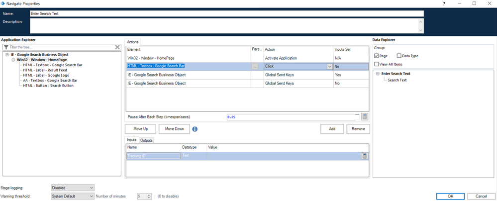

1) Use a 'Navigate' stage and there you first activate the application window which should be spied using Win32 mode. This will help you bring the application at foreground. You can use the 'Activate Application' action for the Win32 element as shown below:
NOTE: The entire browser window container should be spied while using Wind32 mode for the element and not just the inner window under address bar when spying with Win32 mode.
2) Now send the click to the element where you want to clear your text. If your element is spied using 'Browser' mode you will get the 'Click' action which requires no input, otherwise with any other modes you can find the relevant action to send a click like 'Send Global Mouse Click Centre' action where you can pass the input text as "LEFT" so that a left click is triggered. Keep in mind that this should be the element where you want to clear your text entirely which in my case is the search bar located inside Google homepage.

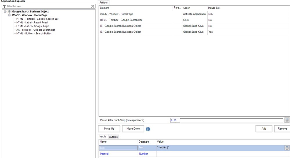

3) Now you should use the root element of your application tree for using the 'Global Send Keys' action. Many people commit the mistake here at this step only where they use this action with the element where text needs to be cleared. In my case, the top most element name is 'IE - Google Search Business Object' and to delete the entire content I am sending the value of the special keys which is: "^a{DEL}"  This is equivalent to press first Ctrl+A button and then press Delete button which selects all the text on currently focused element and then deletes a text.
If the above step 3 does not work, then the other alternative that you can try is instead of Ctrl+A and Delete send something like Home button then Ctrl+End button and then Delete. This means that the cursor goes to the starting of the element and then we select everything till the end and then delete the selected text. If you go via this approach, the text to be passed is: "{HOME}+{END}{DEL}"

I finally solved my problem and wanted to share my solution. In addition to Devneet's suggestions I found this document on sending keys to be helpful.
It took some trial and error, but here are the steps I did:
1. Activate the main window: I spied the main window in Region Mode and although I successfully spied the child element "Source Agreement" this did not work, so I only used the parent element.
2. Spy the element in UI Automation Navigator: I spied Source Agreement this way and used "Focus" and "Global Mouse Click Centre".
3. Send Global Send Keys to the business object: I sent the command "^a{DELETE}".
4. At first I was having an error with the wait stage- I had it set to check if Source Agreement exists before clicking, but after removing that condition the wait stage worked.
