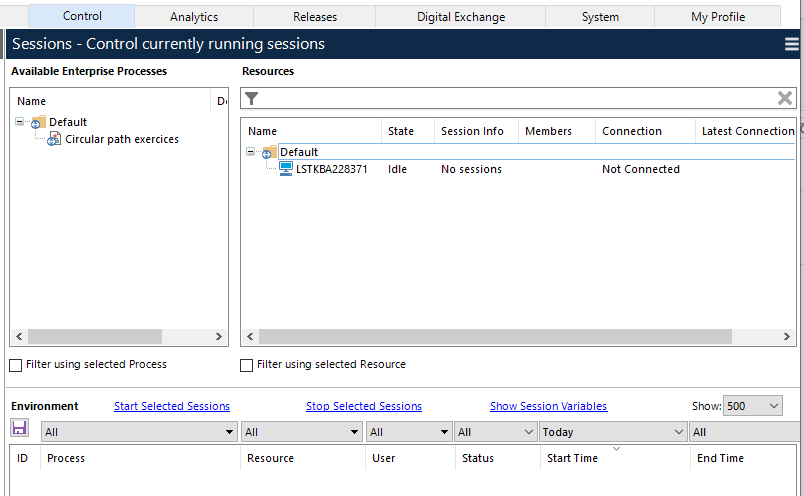

Hi, Im new to Blue Prism, Im doing the course: https://blue-prism.docebosaas.com/learn/course/180/play/1504/control-room
and my digital worker says Idle and Not connected, how i have to connect it?

Hi Lucia,
Could you check on System Tab - Settings if this option is Checked? If not, please check it and try again.

HI Lucia Lisdero,
As mentioned  by other member  you can update the setting  if not updated earlier and close the blue prism instance and open  to see the changes in the control room.
