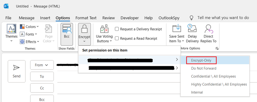

I'm posting this as a top-level discussion for anyone that may be looking for an answer to the question of whether the Outlook VBO can be used to send encrypted/signed emails.
I've looked into this a bit based on information I've found on the internet. Creating an encrypted email in Outlook is pretty easy when you do it manually via the UI (assuming your Outlook client or Exchange server are properly configured). Microsoft provides a handy little button titled Encryption on the Options tab.
Unfortunately, doing this programmatically via interop with Outlook is bit more of a pain. 🤦‍♂️ Below is some code you can add to the Code stage in the Send Email action of the MS Outlook Email VBO that should allow you to encrypt and/or sign emails (assuming you have an appropriate certificate installed and configured):
