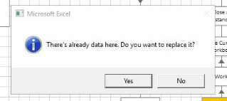

I am using Vlookup formula for one of the column in Excel. I am sharing the flow of the process, I am using Vlookup formula in set cell value.
So the issue is ,Occasionally i am getting error at paste action, but sometimes its running fine So I am not getting the things when exactly its throwing error.
Second thing the column in which i am applying this process, there is already data present ,So it should override that thing ,I checked that it was overridng and running fine but now this issue is coming . At the paste action I am getting Popup like 19542.png
But still i am not sure why is this happening because sometimes its running fine and sometimes getting this issue. Please hep me with this.

When you say the values will be getting added time to time then we can easily calculate the no of rows of the sheet and perform "Copy and Paste Worksheet range" action. And also, if there are any existing values, then why can't we select them all and perform clear contents from blue prism?
It will solve the problem of overriding​. Please let me know if it doesn't work and we can connect over it to resolve the issue.

Actually i have already checked the first link so in that he is using the same thing Set cell value and i have also used the same but getting error .
So I have already mentioned in the query ,the popup I am getting ,so my concern is that is there problem with overriding or what because I am not getting this error always , thatswhy i am not getting surity  that what is the exact reason behind this.

yes this query has been resolved, and yes for this i am using the same thing what you have suggested (Copy paste range) and before using this I am just deleting the column values (clearing content which is already present) and its working fine now. Hope it should not create any issue now.
Thanks for Your response
