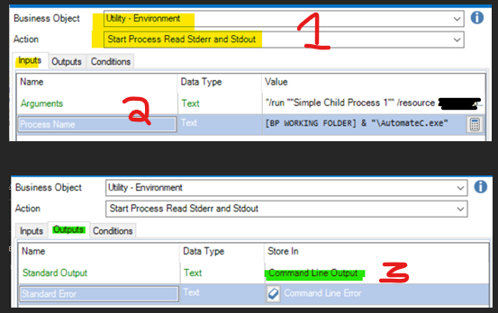

It is possible to get the session id. But we have to use a BP Action to make it happen. The session ID is returned as part of the standard output when a command line is run from a BP Process. Here is something that I have working because we use this system to run processes that are listed in a specific order in a configuration file. I'm posting this here as it may help the community.
Step 1: Run this  command line using the "Utility - Environment::Start Process Read Stderr and Stdout" . Here is an example command from my DEV setup:
"/run ""Simple Child Process 1"" /resource MACHINE_NAME /user BP_User_Name BP_Password /startp ""<inputs> <input name='Text Parameter' type='text' value='" & [Text Param 1] & "' /><input name='Numeric Parameter' type='number' value='" & [Num Param 2] & "' /></inputs>"""

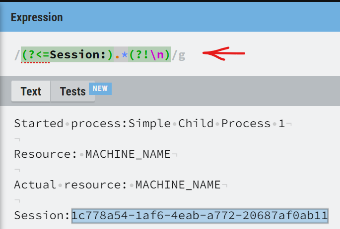

This action returns command line output into two output variables Standard Output and Standard Error. Map these two variables to standard BP Data items.  Once the command runs successfully, the Standard Output data item will have an output that typically looks like this and contains the session id of the target process:
Started process:Simple Child Process 1
Resource: MACHINE_NAME
Actual resource: MACHINE_NAME
Session:1c778a54-1af6-4eab-a772-20687af0ab11
Step 2: Extract the Session ID using the RegEx utility (or string parsing) into a local variable. It would be safe to add a Trim(SESSION_ID) to remove the trailing line break. Otherwise you will be spending hours trying to figure out why subsequent command lines don't work!
