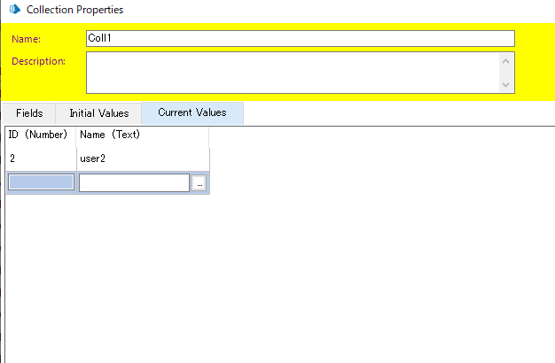

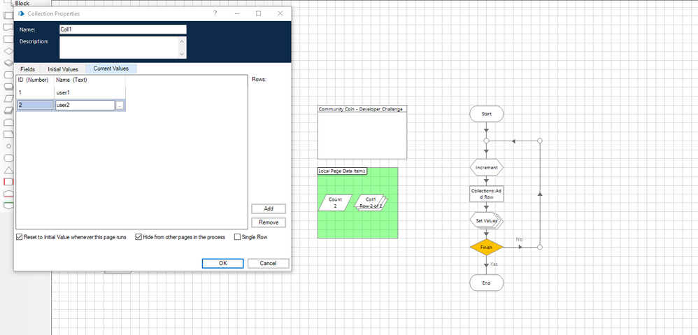

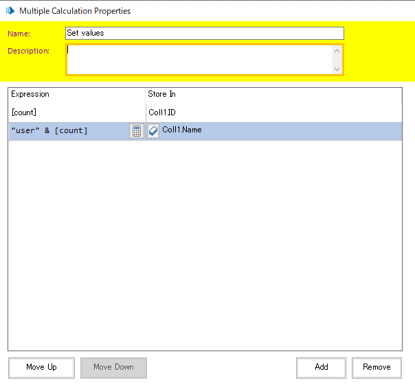

I made this process, but  Multiple Calculation Stage "Set values" set only in the first row in every loop.
I want to set values in the last row after "Add Row" stage in every loop.

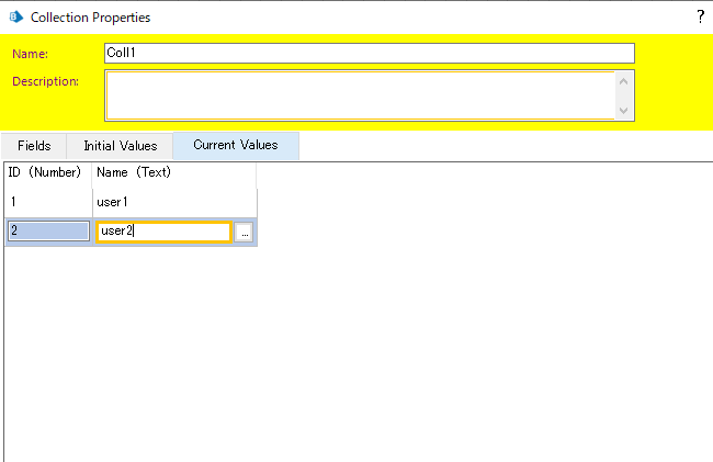

I want to set values like this.

I am able to update the value in the last row using the similar flow. By default, the "Add Row" action will point to the last row index. Based on the screenshots you have attached, I can see that "Coll1" index is still at index 0 after adding a row to the collection. As mentioned by @shashank.kumar280  if possible, can you share your BP release file here.

Now I know why I can't set values in a last row as the default.
There was a bug in the "Add Row" action that was customized in-house and doesn't point to the last row index.
When I use the default "Add Row" action,  it works correctly.
