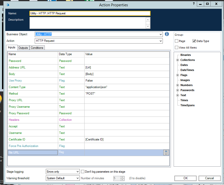

@Venkateswara_R3,
Are you making use of the Utility - HTTP VBO?​ If so, newer versions of that VBO, available on the DX, include support for using a client certificate for authentication. You'll want to check out the Load Certificate action. After loading the certificate, you'll receive and Certificate ID which you can then pass into the other actions like HTTP Request.
Hi @ewilson,

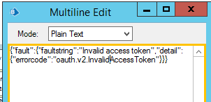

As you suggested above, we have used Load Certificate​ action and we are getting Certificate ID and we are passing this Certificate ID into HTTP Request Action as shown below. Now we are getting error as "errorcode":"oauth.v2.InvalidAccessToken" because we are not supplying any token for request.
Note: We are using AOuth2.0 authentication. Kindly help us where to pass Token url, Client ID and Client secret key.

@Venkateswara_R3,
We started out talking about certificates and now we're talking about access tokens. These are different parts of an OAuth authentication flow. Without knowing specifics of the flow that was implemented by your business team this is just shooting in the dark. Ideally, they should be able to provide you a guide detailing the steps of how to authenticate with their service.
A good site to review for information about the different authentication flows in OAuth2 can be found here.​
