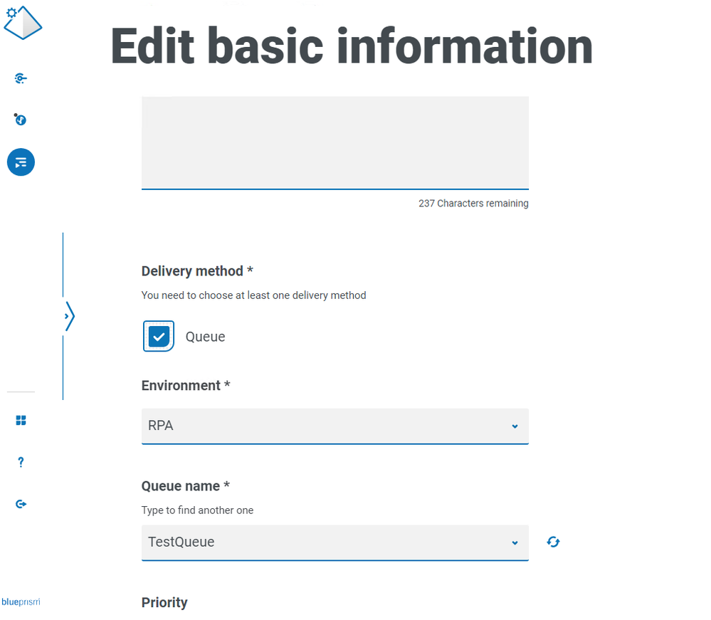

Hi vaikunth ,
 We have the similar issue while working around interact .Please check the below solutions .
1)Check if you have assigned the Queue Name in Blue Prism Hub (You can check this under Forms inside Hub).
4117.png2)Check your BPCloud settings that if it allowing the Interact API Requests .While Configuring check your server details .
Hope this helps .
