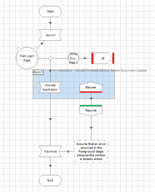

Hi Mia - the Run Mode of an object determines how or if multiple processes can run on one machine at the same time, it's not really to do with whether a window is activated or not. I would advise adding an activate to the end of the launch page, something like this.
John Carter
Hello Mia, I hope everything is going well with you. Regarding your issue, I usually add a "wait" verification stage after the Launch stage to ensure that the page has been successfully opened and fully loaded. Then, I use the "Activate Application" stage to bring the window to the foreground (here, I add a "recover > resume" block to handle cases where an error is generated indicating that the window is already in the foreground). After that, I use the "Maximize" stage to maximize the window.
Furthermore, you can create a page in your object responsible for the "Activate Application" action and call it on all pages of your object, before any interaction. This is done to ensure that the screen is in the foreground, in case any Windows pop-up or similar event has occurred.
Below is a screenshot of an example flow for your reference:
I'm available for any questions you may have.

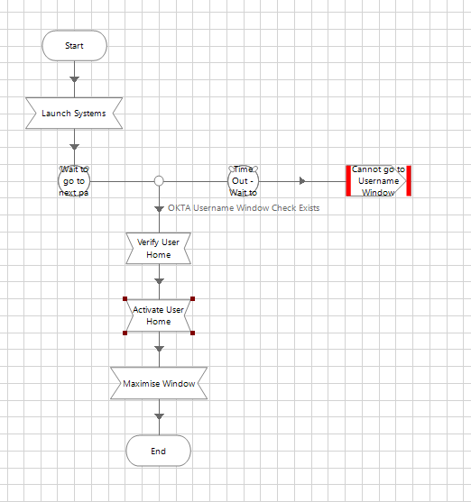

Hi Wagner,
I have followed your steps; it's working, but it's not consistent. Sometimes the screen pops up but another time the screen is hiding and I have to bring it up manually.
I cannot add an activate window and maximize steps in the attached page because it has to step through many screen. I did try this way but it seems not working.
Here are my steps in the launch page
