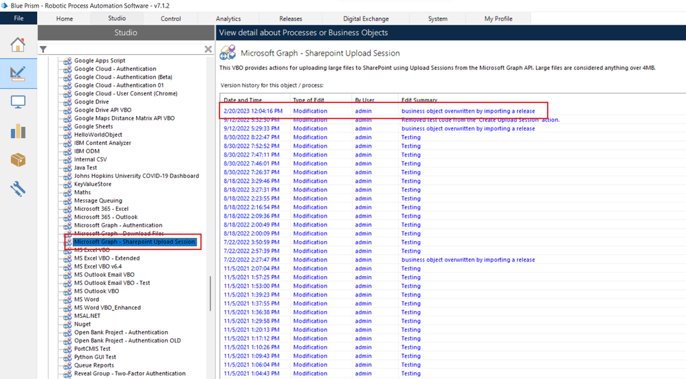

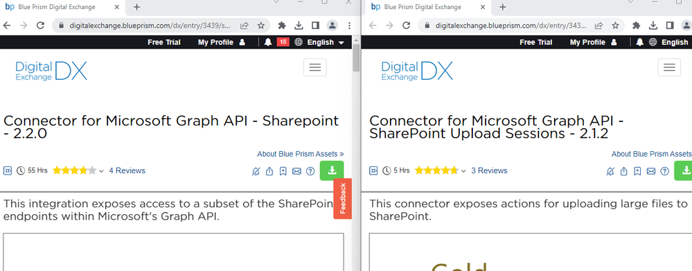

hello Eric Wilson -  2 of the 4 link are for below VBO shown in snapshot.
We should be using the left one . Right? as it is updated one. When i tried to import - these are overwriting to each other means both is having same information and right one (2.1.2) is earlier version then left one(2.2.0).

These are two different connectors. The Microsoft Graph API - SharePoint connector is implemented as a Web API Service as shown in the following screenshots:
The Microsoft Graph API - SharePoint Upload Session connector is implemented as a VBO as shown in these screenshots:
They each have unique IDs and should not be overwriting each other. I've downloaded both from the DX and reimported them into my environment which you can see reflected in the timestamp of each one.
