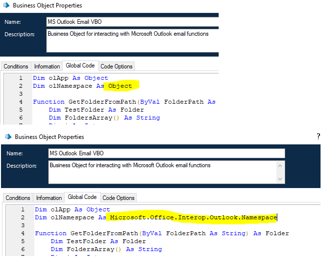

PRASANTHM
Hi Johan,
I replicated this issue,
it's a namespace initiation issue, and also check the "Account Display Name" field "X" is added I guess
