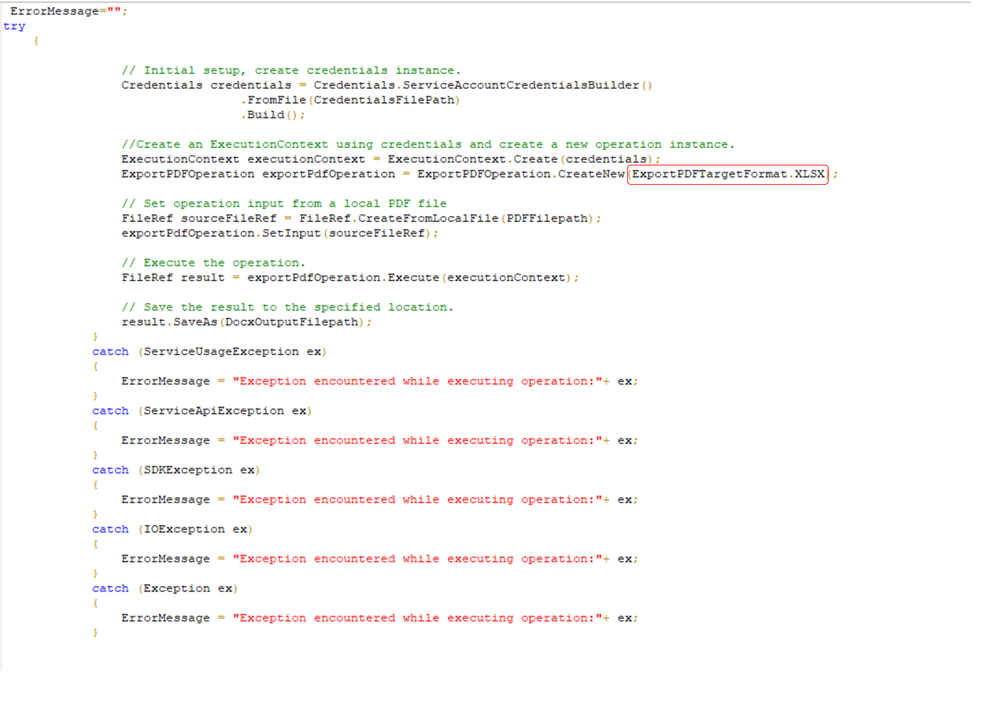

Did you try to tweak the code for the PDF to Docx, action with the below highlighted section:

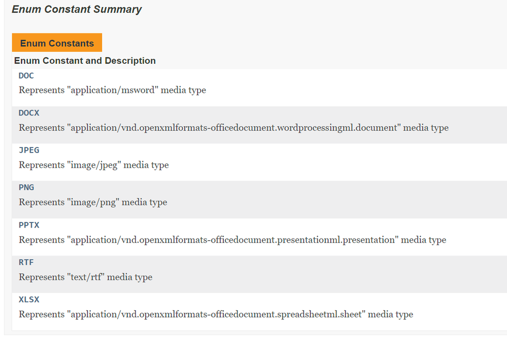

As per the official Adobe Services documentation for this API call: ExportPDFTargetFormat, the ExportPDFTargetFormat() enumerator class can have the following list of enumerator constants:

Yes, Devneet that is what we tried but BP freezes while stepping over the code stage for PDF to  XLSX fr longer times and ultimately have to kill task from task manager

Hi Tejas,
It is bit strange as for me the same is working with a test PDF file. There is an API limit over 200 pages for any given PDF file under the trial license. Can you let us know how many pages does your PDF file has?
