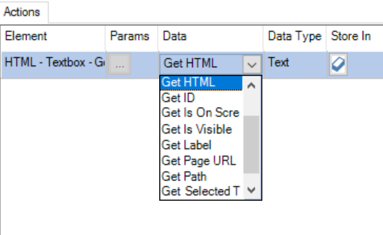

Also, on more way to read element values can be to get the source HTML of your web page by using read stage on your entire web page and use 'Get HTML' action:
![28271.png 28271.png](/t5/image/serverpage/image-id/28403i8D577EF4779C06D7/image-size/large?v=v2&px=999)
From here, you can try to parse the HTML using XML business object and get the desired node value as you want. If it is a collection then you need to loop through and add logic to determine the valid values from the parsed HTML string and insert the appropriate values in your collection.
