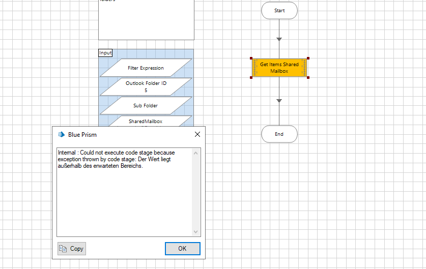

there is an error occuring within the MS Outlook Email VBO (Page GetItemsSharedFolder) reading out the "Sent" folder from a SharedMailbox. Looks like option is defined, but the code is not supporting this functionality.
Is there a solution or renewed VBO?

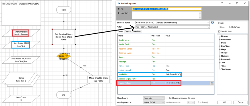

Thank you for contacting us, only the most recent version of MS Outlook VBO supports share folders, this VBO is included with Blue Prism 6.8 and you can copy this VBO to the previous version of our product than currently support MS Outlook VBO.

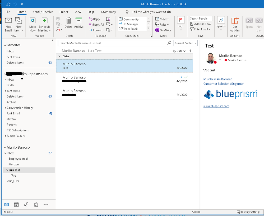

This is how my share folder is
And this is how to move the messages:
I hope this works for you.

Thanks for your fast reply. I am using the mentioned VBO. I can confirm that your examples are working.
Is VBO only build for reading out in the inbox (including subfolders) of shared mailboxes? The error occurs trying to read out the "Sent Items" folder (with Outlook Folder ID 5) of shared mailboxes.
