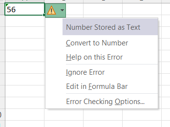

Hi @Michael ONeil,
Thanks for your response. I have a huge set of data in an excel which needs conversion from text to number hence I can't use Get Cell Value as it needs to be done for every cell. While I was looking for a solution which can work on a full column. PFB the screenshot for what i was looking for:
Also, I tried changing the format to '0' but it didn't work.​

Thanks a ton @ritansh.jatwani.
The code worked perfectly fine!!​ 🙂
