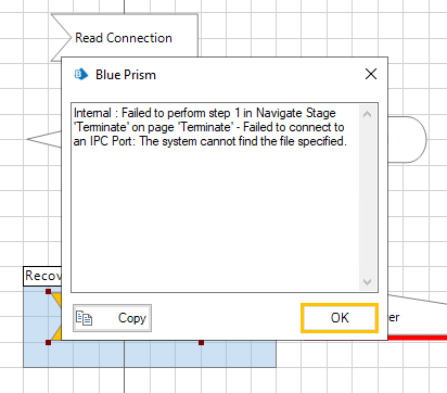

I'm having trouble terminating a Mainframe application that has two parallel sessions running. When I terminate the first session, it also closes the second session also, but when I try to terminate the second session, I receive an error message that says "Failed to connect to IPC Port". Could someone assist me in resolving this issue?
First Session I'm terminating using Navigate stage by passing Session name in element.
While  termination to Second Session I'm getting this error.

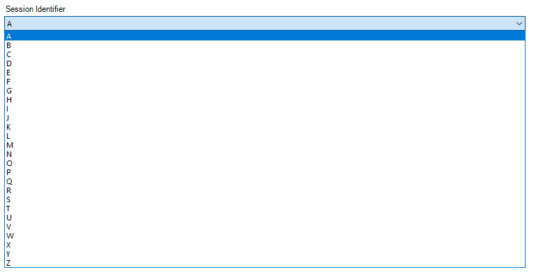

May be its because you are using the same session identifier for both the sessions at the object level.

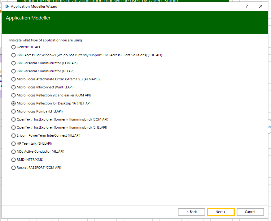

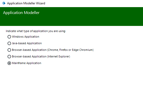

Can you tell which type of appliction you are selecting in application modular?
arpit alne
