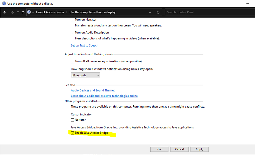

Hi Sourav,
Do you have the Java Access Bridge installed and enabled?
We found we couldn't use Java Automation unless this was installed and switched on.

Hi Jamie,
Yes, JAB is installed and enabled.
While launching the application from IE browser, the Java mode works but when trying to do the same with Edge browser, Java mode doesn't work.
