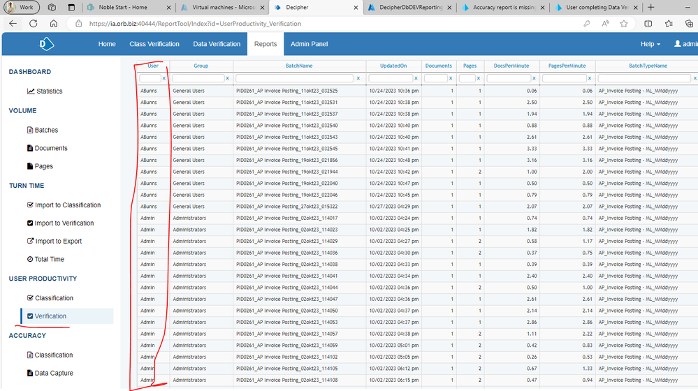

Doesn't the data exist in the decipher database somewhere?

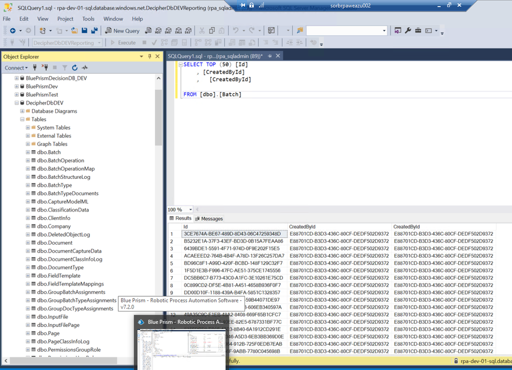

There is a report for data verification which is exportable. Can we query the database somehow instead, and join it with the batch name to get the verifier's username?
Magnus Brangstrup
Hi Ben,
If you can tell us in which Table can we find the User column in the User Productivity - Verification, then our problem is solved. Thanks!

That's not a single table in the database, so it requires a few joins to get the request info.
Prior to sharing this I must advise that running SQL commands against the Decipher database is not supported, and any issues or errors arising with Decipher following this may not be supported.
I recommend running this against the reporting database (if enabled) to minimise the risk and load on your Decipher database.
SELECT SessionTask.BatchId
	  ,Batch.Name 'Batch Name'
      ,UserData.UserName 'UserName'
      ,UserRole.Name 'Role Name'
  FROM [DecipherServerDbReporting].[dbo].[SessionTask]
  LEFT JOIN UserRole On SessionTask.RoleId = UserRole.Id
  LEFT JOIN Batch On SessionTask.BatchId = Batch.Id
  LEFT JOIN UserSession On SessionTask.UserSessionId = UserSession.Id
  LEFT JOIN UserData On UserSession.UserId = UserData.Id
  WHERE SessionTask.Status = 'Finished'
  AND SessionTask.RoleId = 30
You may need to update the RoleId, this is aiming at the Verify role.
This query has not been tested outside of my personal instance and may require additional parameters to best work in your environment.
