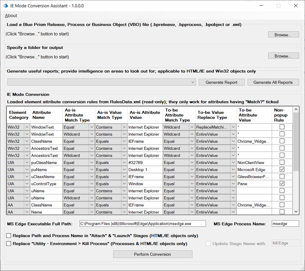

IE Mode Conversion Assitant
This is in fact the exact reason why we have built this utility. It offers out of the box conversion capabilities for the following areas:
  • IE usage found in Application Modeller
  • IE usage found in Attach/Launch stages
  • IE usage found in "Utility - Environment > Kill Process" action
  • Attributes replacements for certain Win32/AA/UIA elements in scope
To understand the full capability of the utlity, please kindly read the user guide comes with the utility.

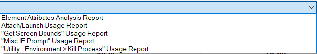

We recognise that the above conversion features will not likely give you an object fully operational under IE Mode after conversion, there are in total 5 reports (see below) can be used to expose additional areas where manual interventions may be required to retrofit the object to work in IE Mode. It works hand-in-hand with our official IE Mode documentation found here.
Please note that there will be some setup/configuration work needed to get IE Mode to work initially. The converted objects will require such work to have been completed in your environment before they can be operational under IE Mode.

A new version of the utility 1.0.1 has just been released to the DX. It resolves the following issues reported:
  • Decrease the data grid table so the application can fit monitor with limited screen height.
  • When "Replace "Utility - Environment > Kill Process" (Processes & HTML/IE objects only)" option is selected, certain conversion changes were not made in the converted file, despite of the mentioning of those changes in the log file.
  • "Update Stage Name" option now only applies to relevant usage of "Utility - Environment > Kill Process".
If you have been experiencing any of the above issues, or are using the early version, please kindly update to the latest.
