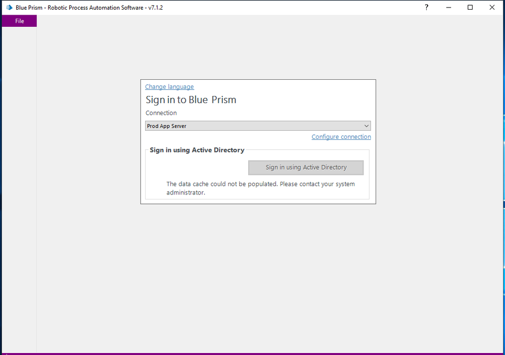

The data cache could not be populated. Please contact your system administrator.
grbanares
Anyone experienced the same before? I just thought I'd ask the wider community before creating a ticket to Blue Prism support.
What was your fix? Thanks in advance!

We've seen this issue can intermittently occur in AD-integrated environments after a reboot of (or maintenance to) the Domain Controller. Does restarting the Application Server Service resolve the issue and allow you to log in?
grbanares
Restart does work but that's not the best solution. It is occurring while the robot is running. It is causing some process termination and schedules interruptions.

We are facing the same problem. Did you get any resolution from the BP Team?
Thanks in advance for your help.

Hi @HarshithKumar! Unfortunately, no solid response from BP Support yet. We have tried upgrading to version 7.2 but this issue is still showing there.

Hi Genold,
In the Command line options (blueprism.com)
/requestactivedirectorycacherefresh helped me to resolve the issue without restarting the service.
Exact command that worked for me AutomateC.exe /requestactivedirectorycacherefresh /sso
I hope this helps.
