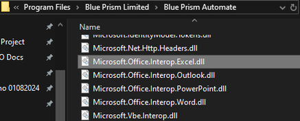

I am doing a excel operation in a process. Process is running on other bots properly, but few bots are showing this error while copying and pasting data from one excel to other.
Exception : Failed to copy worksheet: Invalid index. (Exception from HRESULT: 0x8002000B (DISP_E_BADINDEX))

Check if the DLL is present. Also, try to copy some other workbook and worksheet to figure out root cause
