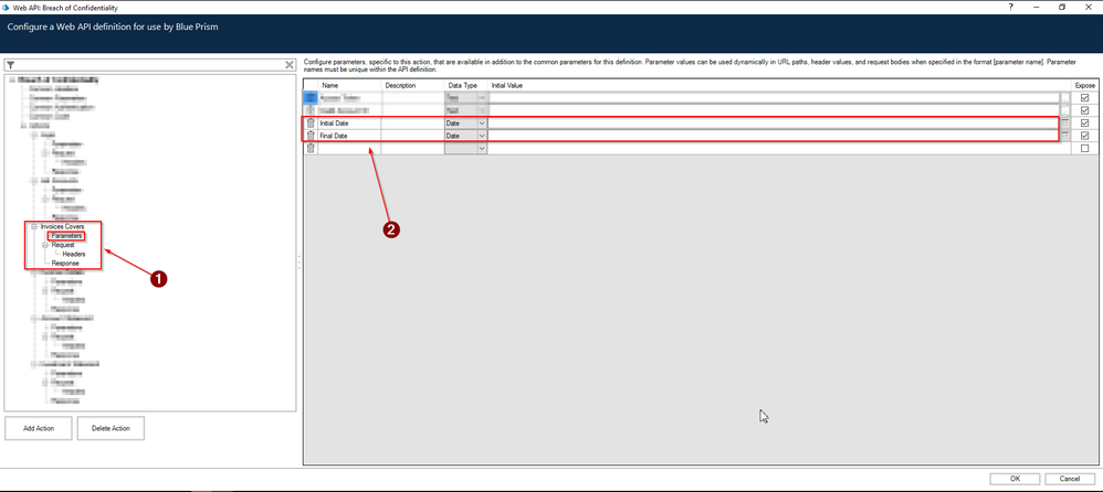

I need to know if there is a way to reference action specific parameters, declared in the parameters tab of an API request, in a custom code request response.

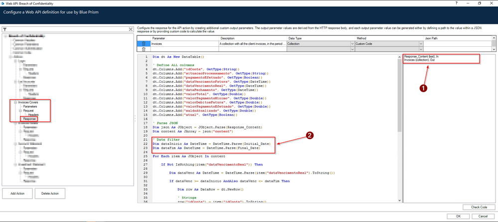

I made a code to extract some data from the response, but I can't make it work. The used code is shown below:

Invoices = dtAs you can see, I have declared the parameters in the parameters tab for the API request, but they are not showed in the bottom corner, like the other parameters.
Did I do something wrong or it's just not possible to do it?
