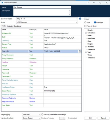

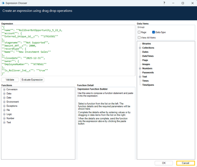

I am trying to perform a curl post for the following,  am not a web developer and have very limited experience with APIs. I am told I cannot use the Web API services in this situation as I need to go through a proxy (no userid or password needed). I was planning on using a string replace for the variable values (Employee Number and External Unique ID) .I have attempted quite a few times to make this work to no avail. I thought I could use HTTP utility below as it supports proxy, not sure of the values (for method) and in particular of what the "body" should look like. I have tried a few variations and keep getting a message saying I have misplaced double quotes. I did look at the other posts regarding curl post but I need something a little more basic

Using the Utility - HTTP VBO, and traversing a proxy, your request will look something like this:
BTW - This appears to be a request to Salesforce. Are you aware we have the Salesforce Power Pack which is an implementation of the SFDC Lightning REST API?
Eric
@a026833 I forgot the cookie part. For that, you'll want to create a single row Collection data item. Set the column name to cookie and its data type to Text. Then set the value of the column to your cookie value (scratched out in the picture). Then pass this Collection into the HTTP VBO request to the Headers parameter.
There are several ways to post data in curl. Below are some:
1. Using double quotes (") twice
E.g. curl -d '{""body"":""this is my message body.""}
2. Using backslash (\)
E.g. curl -d '{\"body\":\"this is my message body.\"}'
3. Using JSON file
E.g. curl -d @'<json filepath>'
or
curl -d @<json filepath>
Sample JSON file content:
{"body":"this is my message body"}
