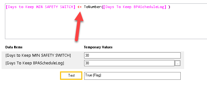

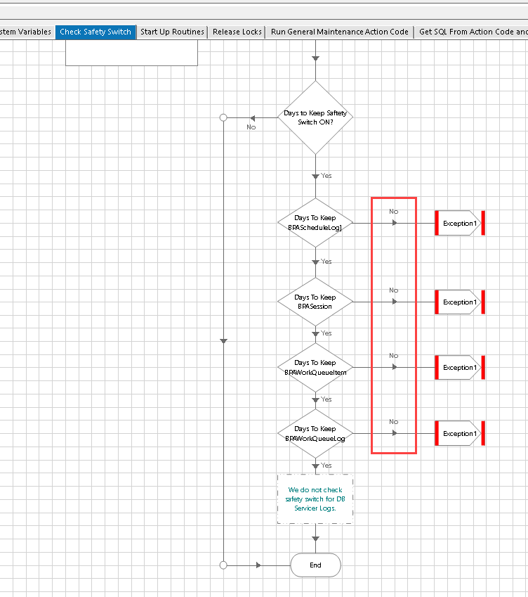

We started using it today and encountered a possible bug. After configuring everything to our needs the process terminated nearly instantly as the Page "Check Safety Switch" did not accept any value that is set higher than the value set for the safety switch.
The solution is to switch all decisions so that no/false leads to an exception, not yes/true.
One more thing that didn't make sense: The decisions all check if the set value is greater than the MIN SAFETY SWITCH. If you set the value to be the exact value of the MIN SAFETY SWITCH then the process would terminate as well. Amending the formular to accept "greater or equal" did the job for us.
