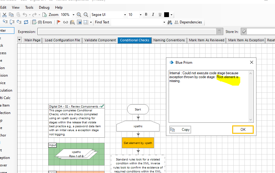

I am trying to test Digital DA Asset for my existing project and getting error Could not execute code stage because exception thrown by code stage: Root element is missing.
This is first time I am trying to implement this not sure what wrong I have done.Please help me to resolve this. Thank you in advace

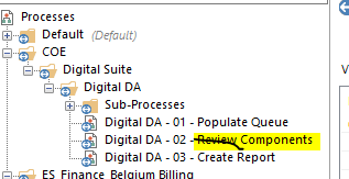

Thank you for your response .I am using Digital DA asset which is Automated Reviewer. Please find link for asset. Blue Prism Digital Exchange
I am running step by step.Populate is queue is working fine. Facing error for review comment process.

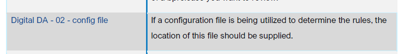

Please find environment variable screenshot also.not sure its wrong ?

Error you mentioned is due to Environment variable - Digital DA - 02 - config file value is not set.
You may like to provide path of your XML config file in value.

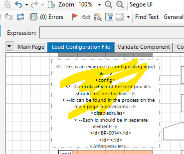

I didnt get any config file with this asset and dont know what will be format for this. If you have please provide me.

Please try to go thru User Guide for Digital DA Asset. It will help.
For your query:
Sample is already shared:
Also, try to check step by step and update values as per input/output parameters.

The error message "Could not execute code stage because exception thrown by code stage: Root element is missing." implies something is wrong within the XML structure.
If you inspect the file in an x-path service such as www.xpather.com, and utilize the query in the stage causing error you should be able to determine where the XML structure is flawed.
