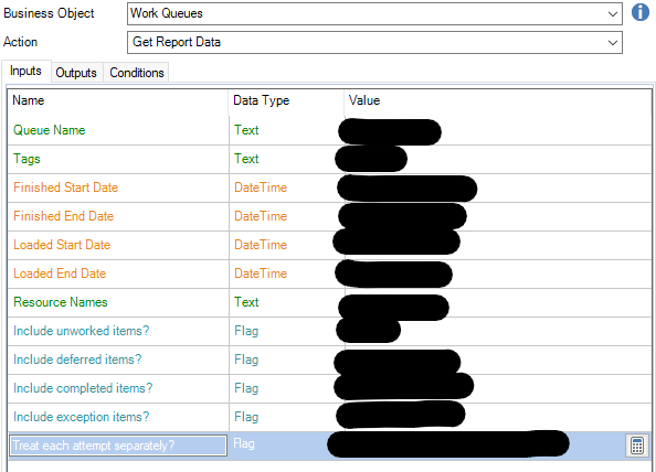

Hi Tejaskumar,
I would recommend you have a process that will use the 'Get Report Data Action from Default Work Queue VBO' to get the specific queue data into the collection and then you can write the collection data into an excel file and save it.
Whenever you need a queue report you can run the process and you can also schedule it as per your requirement this will make our job simple and easy as there are multiple Input data you can specify to get daily queue reports.
Thank you,
Chirag Patel.
(IgniteIPA)
