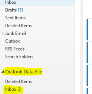

Is it possible to read emails from the .pst files inbox folder and reply to those mails using Blueprism. if possible pls help with the object name and configurations

We have different versions for the Outlook VBO., but the original VBO can only work with an email from the Inbox subfolder. This was changed after BP 6.8.
My recommendation is to download the most recent version of the Outlook VBO from the DX; this is the link:
https://digitalexchange.blueprism.com/dx/entry/3439/solution/ms-outlook-vbo
