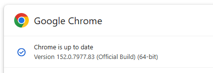

just noticed that chrome revert last update. I update chrome version on one of my resource, now its shows 152xx( earlier its 153xx and causing same issue). Now my process works perfectly fine on all resources after update Chrome version. we are using BP 7.3.1

We are not rollback it. but when I updated on one of my resource it shows 152 is latest version. Screenshot 2026-09-24 133407.png

Screenshot 2026-09-24 133407.pngThis is my latest chrome version.

Sorry, bit confused our admin team follow below steps( which suggested by BP)
https://support.blueprism.com/en/support/solutions/articles/7000095212
So now the group policy has "updates enabled" But it will up date to 152 if it is anything less or greater. ( This is explanation from my admin team). Hope it will helps.
