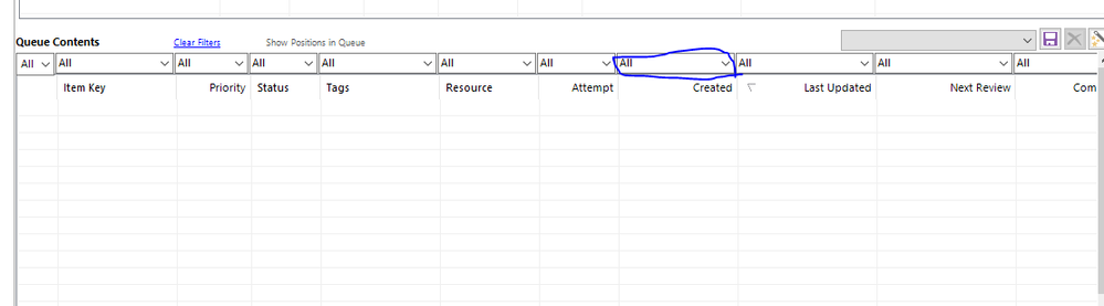

If you're looking for how to set up Active Queues and their functionality here is the documentation Active Queues Documentation when you create an Active Queue and assign a pool(group of resources/machines) for it soon after any item getting added to the Queue it triggers the process that is associated to the pool, but for adding items to the Queue you need a scheduled run again.
For checking newly added items in the Queue you can use the filters that are present in Control Room Queue view
