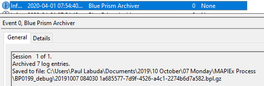

01-04-20 02:16 PM
The Windows event log should have entries when the archiver ran:
And the timestamps in the folder structure where data is exported to should illustrate when archiving was performed.
