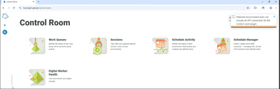

Have installed BP HUB and added a connection but after that it throws an error .
ERROR :- Selected environment does not include an API Connection for the control Room Plugin.

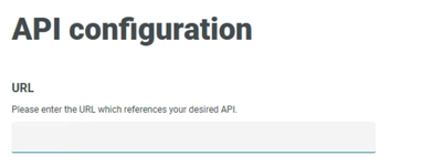

The New connection added was -SQL with Windows Authentication and kept the API Configuration blank.
Can anyone suggest on if need to add the API Configuration URL in the Connection or any other steps to refresh the Environment?

Did you install BPAPI and performed the needed configurations? If not, worth going for a try.

Thanks for the Update, raised a Ticket and team suggested follow BP Api Configuration steps.
