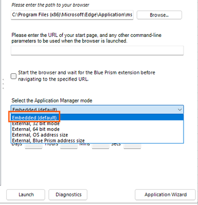

Look in Application Modeller at the Application Manager mode. As far as I'm aware, it has to be set to Embedded in order for multiple objects to attach to Chrome/Edge at the same time. If set to External, it will fail on the second attach. This does not apply to all application types but at least applies to browser mode objects. If it's already set to Embedded in all of the objects involved (such as the one that is failing to attach), then you have a different issue, but be sure to check each.
A couple of options:
1 - As I mentioned above, change to Embedded (in all objects involved).
2 - If you need external for some reason (I have no idea why that would be necessary here), then you could temporarily switch to some objects being Windows application when going through the Application Wizard, and that should work to attach with multiple objects, if I remember correctly.
