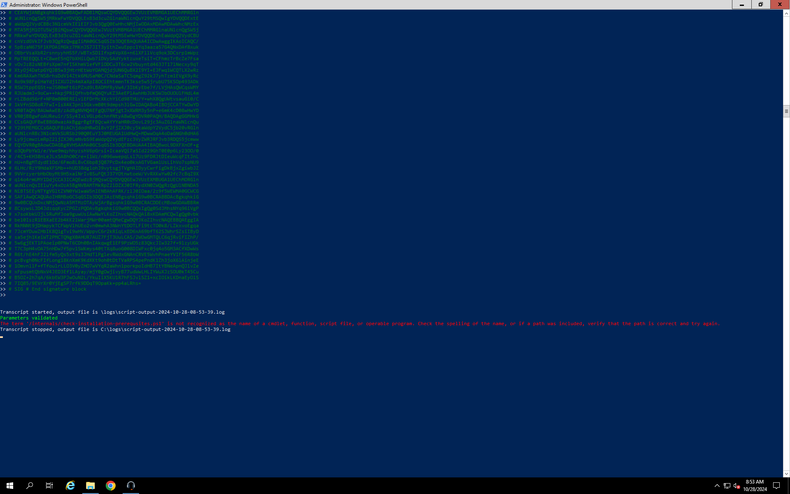

We are Setting up the Blue prism HUB 5.1. and getting error in Power script Run error.
Completed the prerequisites Message Broker setup, .NET Core components, downloading the HUB 5.1 Bundle and Updating the config.jason file with Mandatory details.
After completing, we have run the HUB Power Shell Script and getting the below Log error.
The IIS install, script run was success and success message also came.
Please suggest the Resolution to the Script error.
Log Error details below :-
Transcript started, output file is C:\BP_Hub\BluePrismHub-5-1\logs\script-output-2024-10-28-08-44-24.log
Parameters validated
#-- Checking if IIS component is installed... --#
PS>TerminatingError(Get-WindowsOptionalFeature): "The requested operation requires elevation.
Windows PowerShell transcript end
End time: 20241028084425
Adding the PowerShell window Error Picture below :-
