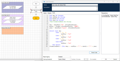

Hi Rabbani,
To get the ordinal suffix below VB code can be used,
Dim day As Integer
Dim suffix As String
Dim month As String
Dim year As String
Dim formattedDate As String
day = DatePart("d", [YourDateField])
month = Format([YourDateField], "MMM")
year = DatePart("yyyy", [YourDateField])
Select Case day
        Case 1, 21, 31
               suffix = "st"
        Case 2, 22
               suffix = "nd"
        Case 3, 23
               suffix = "rd"
        Case Else
               suffix = "th"
    End Select
formattedDate = CStr(day) & suffix & " " & month & " " & year
Input ParameterYourDateField (Date)
Output Parameter - formattedDate (Text)

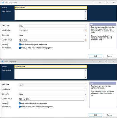

Once we have the suffix as @Mohamad_747 we can append the suffix to the date using below expression,
"Day([CurrentDate]) & [formattedDate] & " " & Left(MonthName(Month([CurrentDate])), 3) & " " & Year([CurrentDate])"

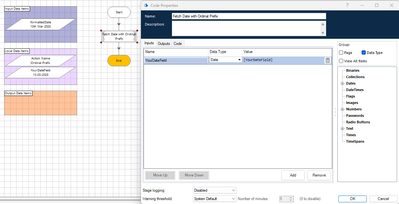

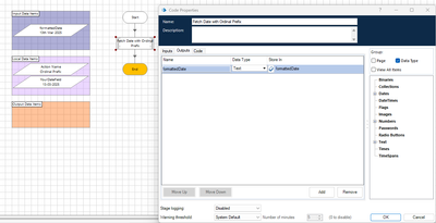

Hi @rabbanir,
Please find the screenshots attached,
