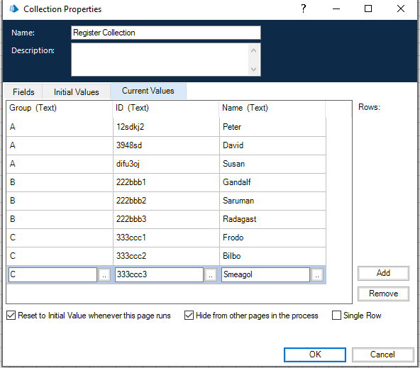

For your example, if I set up a dummy collection to match your spec's, you can see there are nine rows across three Groups:

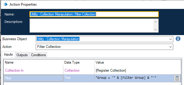

To filter down to a particular Group, the action parameters look like this:
Note the format of the filter expression. The filter parameter (i.e. the [Filter Group] part) needs to be enclosed in single quote characters, when it is a text field at least:
If it helps, you can think of this as being like an SQL query.

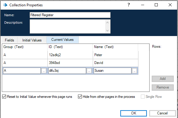

The result from this when [Filter Group] is set to "A" is the three A group rows in the specified output collection:

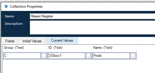

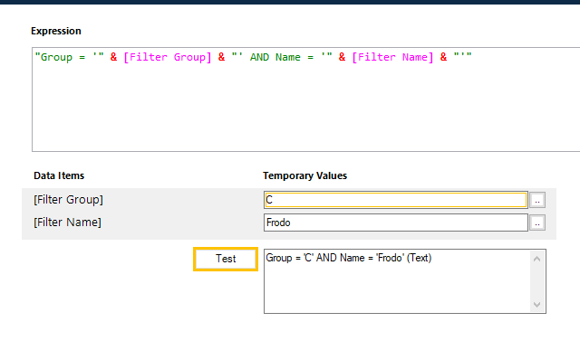

Or, make your filter expression more complex depending on your needs...
Which results in:
