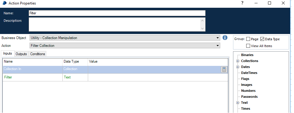

Hello Andy,
In this scenario, you can go through the main list and perform the appropriate validations using it as a base.
In the process, create an action and select the option "Utility – Collection Manipulation" and select "Filter Collection"
In Entries select the Collection you want to filter. Create an expression that must be placed between Strings " " as a reference to what will be filtered and from which column.
Example: "[exemple] like '%temp%' "
The output will be a Collection where the filtered data will be stored. For quantity validations, you can use "count rows" for this validation;

Hello Andy, you can achieve what you want in various ways, but I'll provide what I believe is the shortest. After all, there's no need to reinvent the wheel, right?
What you need is use Distinct function that you can obtain through this asset in Dx (It is on my box of preferred VBO's) millicon---collection-utility
With the "Distinct" action, you can obtain only the unique values of a column. Assuming that there will always be 3 rows, using the "Distinct" action will cover all scenarios that you mentioned.
If the main collection has 3 different fruits, the output value of the "Distinct" action will be 3 rows.
If the main collection has 3 identical fruits, the output value of the "Distinct" action will be 1 row.
If the main collection has 2 watermelons and a pineapple, the output value of "Distinct" will be 2. In this scenario, you can loop through the distinct collection and use the value to filter in the main collection with "Utility - Collection Manipulation: Filter" to determine which kids have 2 fruits and which have 1.

Thanks Daniel. It worked.
