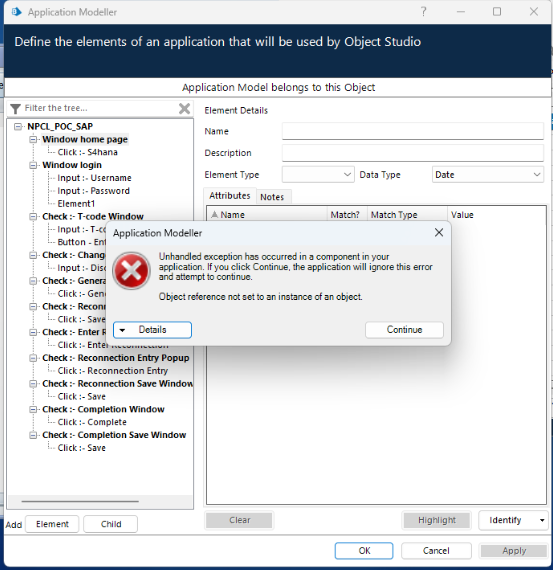

20-09-23 07:53 AM
Hi Eric,
I have Imported a process that was developed in bp 7.1.1 version to bp 7.0, but not able to use the objects and the attributes are not being displayed.
This is the Error Im facing with, Also the link to Studio Display Fix utility on the DX is not accessible.
Kindly please suggest on this.

20-09-23 02:22 PM
The Studio Display Fix utility has been replaced by the newer Compatibility Tools 2.0 utility.
