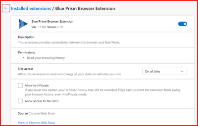

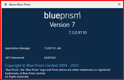

mparikh
Is there any latest version for Blue Prism Browser Extension then 2.1.0? This came along with the 7.3.0.9110
Edited reply: I fixed it by updating the Blue Prism Browser Extension to 7.3 from Edge addons page. Thanks!
