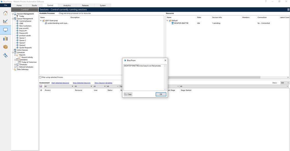

Error-DESKTOP-8*******E is too busy to run that process.

Hi Gaurav,
In the Environment area of Control Room, change the drop down list above the 'Start Time' column, from 'Today' to 'All'.
This will show all sessions from all days. You can change the Status column filter to just show 'Pending' to make it easier to locate the session.
Once you have located the session, right mouse click on the session and select Delete.
Hope this helps.
Carl Carter
Developer Program Manager
vivek.kumar.goel
Apart from what Carl has stated, if your process employes 1 or more foreground/exclusive objects, you wouldn't be able to run multiple sessions of this process on the same machine.
