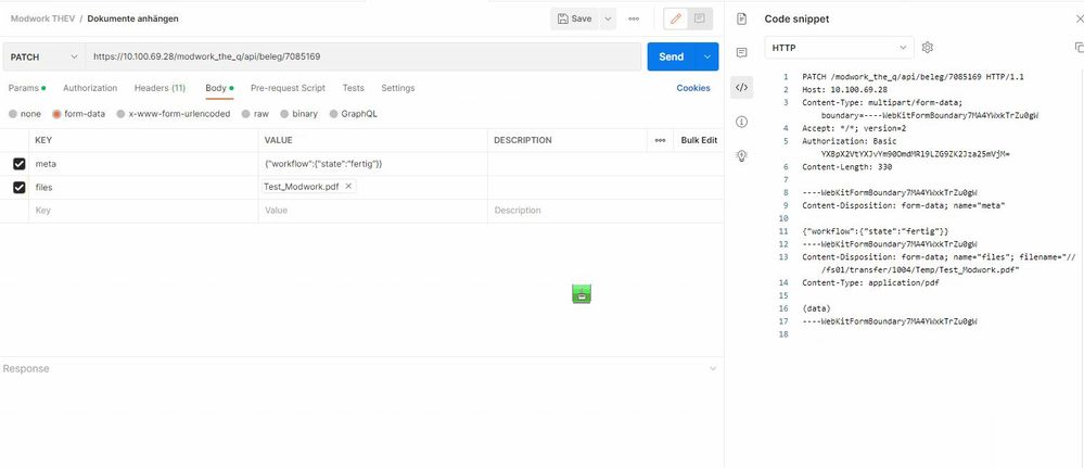

In Postman I'm able to upload the file with a PATCH request.
This is how I build the request in Postman:

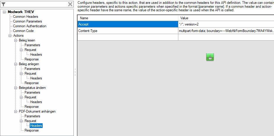

And these are my settings in Blue Prism:

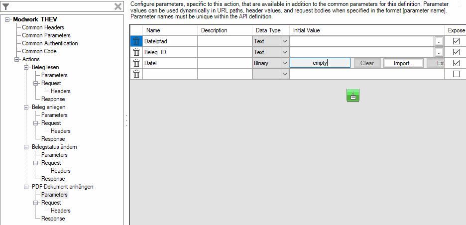

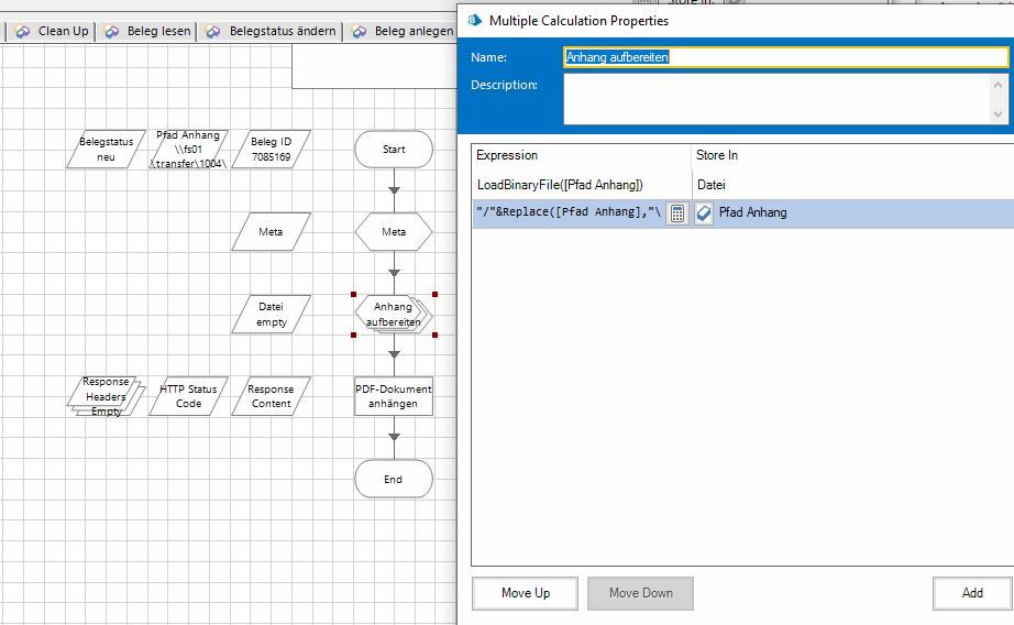

I load the file in a binary data item with ‚LoadBinaryFile([Pfad Anhang])'.

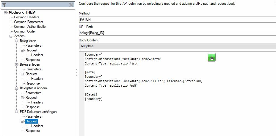

I've tried to use the body content ‚single file' as in the bpdocs suggested. But the API needs the field ‚meta', so I have to set the body contet as template.
I also found out that if I leave the data item fort he file empty, the request is succesful. But of course no file is uploaded.

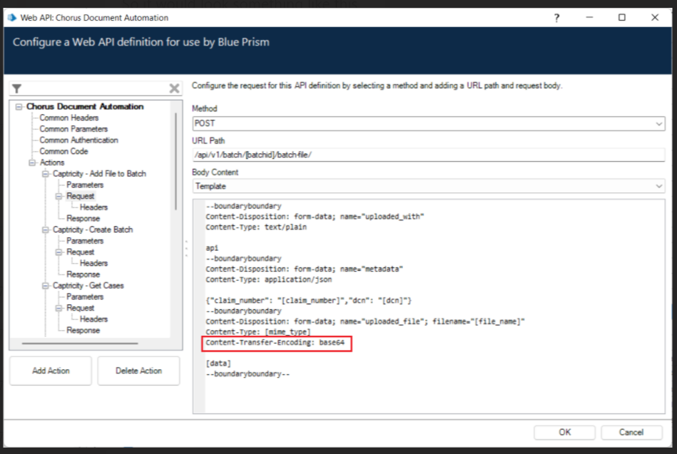

@Michael Krey @ewilson
I had a similar issue earlier with another api. It might help to add HTTP header that calls out that the data is Base64 encoded .
See highlighted in red below.

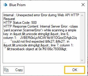

We've seen this scenario (a 500 error when uploading multi-part data) in the past with customers integrating Blue Prism with Appian. The issue is usually related to how Blue Prism transmits the body of the JSON file.
While you may not be using Appian in particular, this KB article may be of some use. It suggests to inspect the JSON file being transmitted by Blue Prism to check if the data is being passed in a collection or not, and adjust the endpoint to allow for (Content) -- i.e. a Collection in a single item, if possible.

yes I'm still using the same Web API, that's correct. And I use the data item 'Datei' to pass the PDF.
In my corresponding object I load the file with 'LoadBinaryFile' and pass it in the API.

@Michael Krey,
One issue I see is that your ending [boundary] needs to have two dashes at the end (ex. ​------WebKitFormBoundary7MA4YWxkTrZu0gW--). The two dashes at the end notify the receiving server that it's the final boundary of the upload (i.e. end of the request). So in your Web API definition you could change that part of the template to look like this [boundary]--.
I'm still not sure why the data represented in the two captures looks different though. Did you pull both of these from Fiddler or did you grab the Postman capture directly from Postman? I've checked with engineering and they said they do not Base64 submissions within the product.

@ewilson @shashank.kumar280
Thank you very much for your help. Finally it works. You really made my day!
