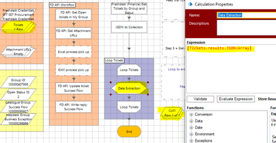

I'm trying to work with Freshdesk, a procurement solution, and they have CAPCHA at their sign on stage. So I have used an API to call all open tickets in my group resulting in the response content in JSON format. I have then used the Utility - JSON object to put it in to a collection.
(The Freshdesk Developer documentation won't support me adding in the subject as a parameter to the API call)

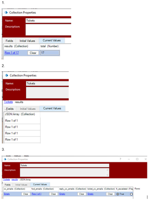

There seems to be 3 layers of collection to get to the actual data:
And now I'm having trouble extracting the rows in to a new collection so I can filter it. Advice has been use a calculation and loop which I've built but it only picks up one row and exits the loop. Other advice has been to use some custom code in the response but I don't have the expertise to write this, or get chatgpt to write it...)
I want to be able to filter by subject that starts with RFC to get the relevant tickets for the process and add them tot he queue, but I think I need to get it into a format that can be filtered first?

You can try, JSON Utility, where there is an action to skip JArray as well. Hope that helps.
Similar issue, pls checkout this thread(Answered: Re: Response Content to Collection - SS&C Blue Prism Community). it may help.
