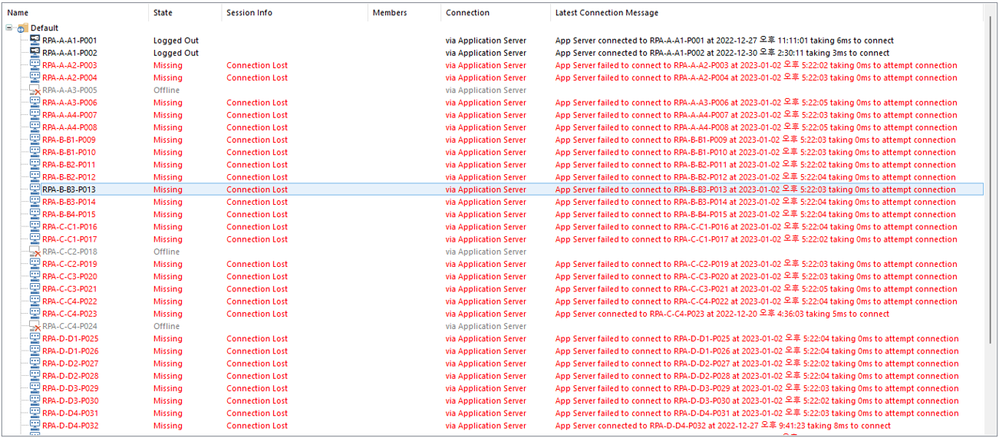

I turned the servers off, in order to remove some runtime resources.
Most of them were changed to its state as Missing.
AP server seems to be trying to reconnect to those servers, consuming its system resources.
Do any one have a guide for normal sequence for shutting down the runtime resources?

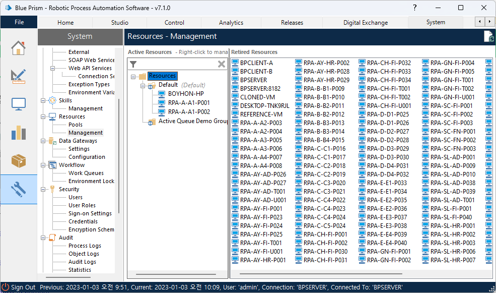

You can 'retire' old unused resources in Control Room.   From memory I think the UI is easy to guess at,  either drag to a retired box (maybe that is the old UI??) or right click the resource to retire.
I retired many resources already.
The area of retired resources is crowded.
When will they die?
Or how can I erase them?

Are you clearing down your session logs regularly?
I suspect the final deletion of archived resourses might be linked to the deletion of your session logs otherwise the UI would throw up some infamous foreign key constraint errors because the resourse related to the session log can't be found.
Deleting or archiving session logs is very important for product efficiency and reliability.
If that does not ring true and your session logs are tidy then maybe someone else has an idea of how to do this.
I have the feeling I cannot confirm that the "Retired Resources" get removed once the Session Logs are cleared. Maybe I am doing something wrong but I have the feeling this is not doning is. I also checked the unofficial DB cleanup scripts but they do not contain anything on the retired Resources.
