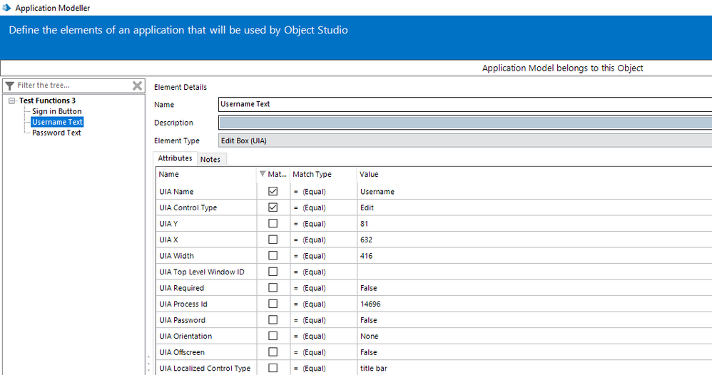

Ok finally I made it. The trick is to spy as Browser -  UIA mode any element on the pop up and then manually change it as shown below to the adequate element. Automatically the spying doesn't work
