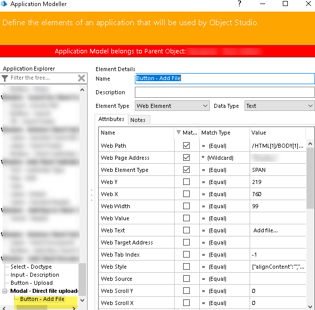

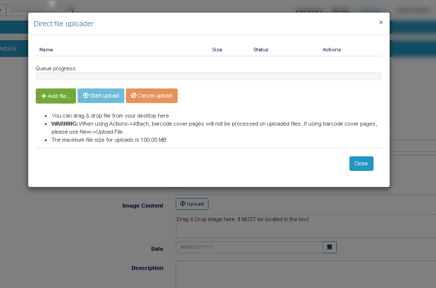

I'm trying to interact with the "Add File" button in this modal window.  However, nothing I've tried has successfully activated the "Add File" button.
  • We have BP Extension installed (V2.0.0.1)
  • We are running Chrome 76.0 in our BP environments.
Navigate stage looks like this.
App Modeller:

Have you tried UIA spy mode so that you could try Global Mouse Click? That should do it if you can identify that element uniquely with UIA.
Dave Morris
3Ci @ Southern Company
Atlanta, GA
Hi Dave, thanks so much for the response.  I just tried but unfortunately, UIA mode is only picking up the (entire) window and none of the unique elements on the page.
- Best,
Kerrie Whelan
Technology Product Owner
Lincoln Investment
America/New_York
Region worked tho!  Thanks Dave 🙂
Kerrie Whelan
Lincoln Investment
America/New_York
Awesome! I was about to suggest that next. I just stay away from it in a browser if I can because it's so easy for a button to display differently based on zoom level, screen resolution, etc.
