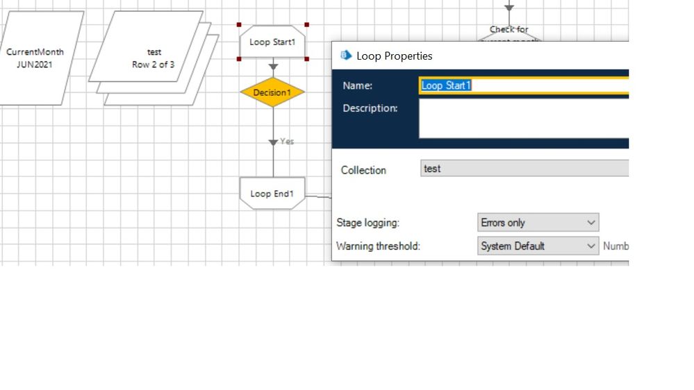

I have installed BP 6.10 and when i am trying to evaluate the expression from a collection,i get a error stating :
"System.NullReferenceException: Object reference not set to an instance of an object."
I am having values in collection (current values) .
1.jpg :showing the data item.collection and Looped collection

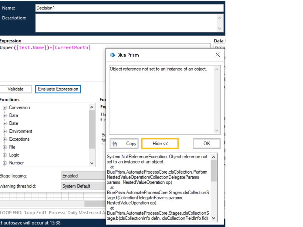

2.jpg :showing decision calculation
3.jpg : Error popped up when evaluated expression.
Error Details:
at AutomateUI.frmExpressionTest.MakeRow(IDataField item, Int32 top, Int32 tabIndex, Int32 scrollbarAdj)
at AutomateUI.frmExpressionTest.Populate()
at AutomateUI.frmExpressionTest..ctor(Control owner, clsProcess proc, String expr, clsProcessStage stage, String name)
at AutomateUI.ctlProcessExpressionBuilder.TestExpression(String localExpr)

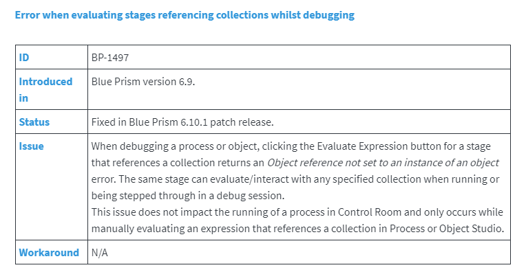

This is know issue since BP ver 6.9. It is fixed with 6.10.1.
Right now am using 6.10.1 and confirm this is fixed 😎

Usually this error pops up if the field from the collection does not exist. Do you want to share a screenshot of the fields of the collection from its Current tab?
