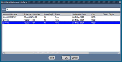

I need help in reading the below table with any other mode other than region mode. Since this is a dynamic table hence using region mode I'm able to read only by cell by cell and there is no parameter to increment the value so that we can move to next cell. Hence need help or is there any configuration that can be done from oracle side so that we will be able to read the table using other modes using blue prism. The below attached is the table for your reference.
From this table i need to read request ID, parent, status and phase column values. I'm currently using blueprism version 6.10
Even the below table also not working in any other mode other than region mode. Here we need to select the row with latest statement date. It is also dynamic.

By the screenshots you have attached the application looks to be a java based application,
Have you tried using Java mode for spying the elements in this application?

Thanks for your response actually I'm not able to spy with any other mode other than region mode. That was the actual issue i was facing.

To spy the application with Java mode, you need to enable the Java Access Bridge first. To do so, please go through the steps here and give it a try - https://docs.blueprism.com/en-US/bundle/blue-prism-enterprise-6-10/page/Guides/java-access-bridge/java-access-bridge-jab.htm
