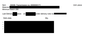

I am looking for a way to get this whole block of text as a paragraph of some sort.
My main issue is that this paragraph may sometimes be multi-page.
How do I assign a region to a multi-page field, is there a way to indicate the START and the END of a paragraph, or is there some other way to do it like maybe split the whole document into multiple sections?
This is the current setting for its field:
Any suggestions?

Hmm, what about using a fixed region inside a table, is that possible?
I would create a fixed region on the whole document, and each row on the table will basically be the contents of 1 page?
