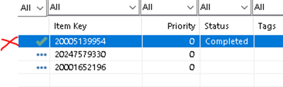

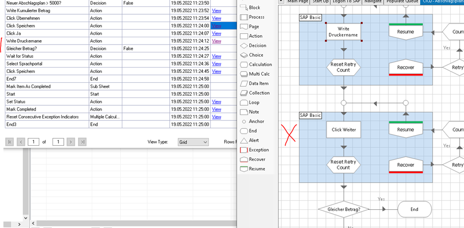

Under Control Panel Queue i open the Ession Log Viewer for a queue Entry:
But the Action "Click Weiter" are not written in the session log:
The Action "Write Druckername" are written in the queue. "Write Druckername" and "Write Click", both have Input Paramters.
It's a Bug?

Hi Robert,
Happy to lend some assistance here, if items aren't showing up in logs then we want to check the logging on those individual stages.
6.10 introduced changes where logging wouldn't automatically be "Enabled", so items may not appear without them being actively changed to "Enabled".
Could you confirm the logging on the actions where you haven't seen the same in the log?

19-05-22 01:32 PM
Hello James,
the question is now, where i can check, where the actions are enabled in Blue Prism?

19-05-22 03:00 PM
Thanks James,
I have found it. 🙂
