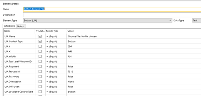

I've spied a browser element using UIA mode using edge browser. When bot is running Blueprism fails to highlight the element and strange thing I noticed is if i add one new element in application modeller and spy the same icon by selecting same attribute, it works fine and even the previously failed element also highlights fine, but only when i add a new element. Attached image has the attribute selected details.
I've tried wait time upto 10 Minutes too, it's not about the delay neither element attribute getting changed. It's very weird. How do i fix it?

Could you please share your Application Modeller attributes screenshot or UIA Mode?

did you checked in debug mode in bot machine ? and also can you please share the application modeller attributes screenshot as Faheem mentioned.
Sushmitha.C
adding the AM screenshot
Have attached now
Yes in debug mode as mentioned it fails to highlight, only when i add one more element with the same set of attributes it starts working fine again.

Please try with Wildcard option for UIA Name instated of Equal
Choose* or Choose File*

Tried that but for some reason enter or click isn't doing anything and not throwing error also. It just goes to next stage without doing anything
Tried that as well, same issue is happening.
